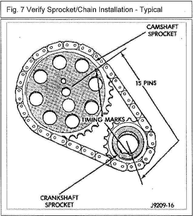

So I finally got a hold of Melling's tech support. Apparently we're not supposed to line up the cam and crank sprocket dots dot to dot. They sent me a diagram of the installation.
One of my many concerns though, is our timing set has more pins/teeth/links. When/why did Jeep update the timing set? I assume this means the 15 pin rule no longer applies.
Posts: 3293
Re: Second guessing 4.7 recipe. Stroker won't start
Rinkrat456 wrote:When/why did Jeep update the timing set? I assume this means the 15 pin rule no longer applies.
The 4.0 I6 had a single roller chain up to '93. From '94 onwards it was changed to a silent link type so for those later models, the 15 pin rule no longer applies.

Is there a way to verify the chain timing without following any rules of dots or pins lining up? Like I mentioned above, it seems the cam is opposite of how it should be so I could start by rotating the cam gear roughly 180 +/- 30 degrees either way.
The 15 pin thing was just to verify that it is in time, not to set it up. And it no longer applies.
To check if its in time you need to degree it in.
