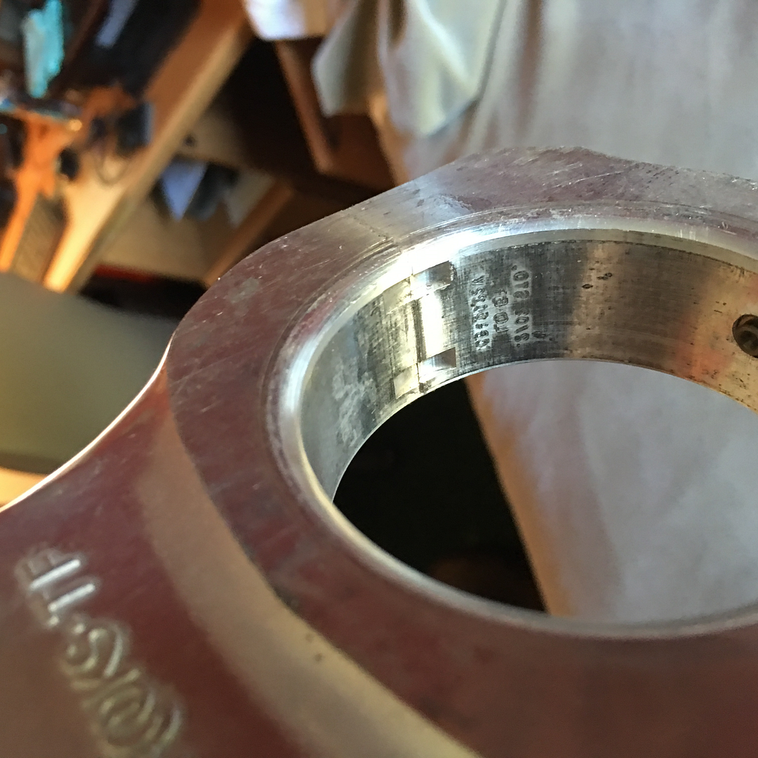

BA, I've worked on Top Fuel engines and one of the aspects we look for are the some of the factors you mention. I can show you rods and caps with the bearing imprints in them. Would you like to see broken main caps to go along with them ?
My point which you cannot seem to grasp is this a simple inline 6 engine used for a mundane purpose. While your shot of NO2 would work for a drag racer it's hardly applicable to the usage most of us are asking this engine to perform in.

I mentioned TF. Here is a picture of a Brooks TF rod that you can see the markings of the bearing transferred to the rod itself. This is from only one run. It didn`t fail but it did tell us how that cylinder was running. From that same engine at the same time the mains looked fine. Again, think about what is written before jumping to a conclusion.
