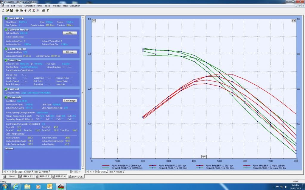

Desertjr, here are your requested sim's mate: (all on one graph, thanks Retlaw01XJ
3.935B x 3.500S = 255cid, -0.012deck,15.3cc piston dish, 0.051HG, 1.95"/1.54" valves: 9.57SCR
Comp Cams 231 & 232, Mopar 229 & OEM '96
I hope that's all legible, I'll add tables for you shortly.

Screen shot is low quality.. and barely legible. Can you upload the original and provide a link? Or add as attachment?

Looks about the same... The overview is good, but its difficult to make out what colors line up with what cam. Does photobucket down sample the images??

I just checked & I'd say yes. The original file is 1.25MB, the Photobucket file is only 144KB.Muad'Dib wrote:Looks about the same... The overview is good, but its difficult to make out what colors line up with what cam. Does photobucket down sample the images??
Can you suggest a better way to upload?

I just found the "Add attachment" option. Try this one Desertjr

Idk why but it won't show. Just blank box with a ? Mark in it lol. Can you possibly upload to photobucket and link them on? I can't thank you enough for helping me confirm though! Also great info for other people who search for this kind of information!
However from the one you posted above of the graphs, it shows the 96 actually being worse than them all down low, but more power up top. Did you run it at 4* advanced? I can make them out ever so slightly & it looks like the Mopar229 beats the comp 232, and the comp 231 beats them both?

Sorry mate, not 4* advanced, I'll redo that for you.Desertjr wrote:ruffy01 wrote:I just found the "Add attachment" option. Try this one Desertjr![]()
THAT'S BETTER
I'll clean up all the duplicates above.
I'm not sure why the attachment isn't showing for you, it shows here really well.
Can anyone else see it???
