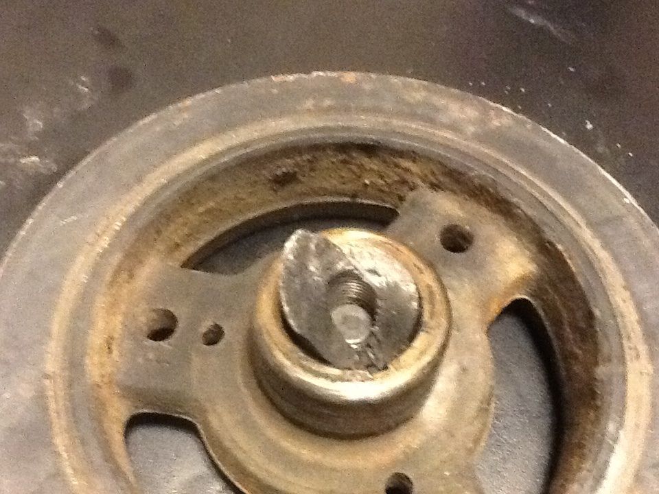

My crank snout snapped at around 26-2700rpm in 4th gear. She's pushing over 300k and still starts and idles fine. It had a weird knock before. I thought it was a rod or main after I check the top end. Nope It was the crank snout or pulley. Luckily it hit no one..made a good 1/2 gouge in the road and ended up close to 1/4 mile away in a gutter. It crossed 3 lanes..I'm dead happy no one was injured. This could of killed someone!

Appears to me the po used a incorrect sized bolt. Length wise. I bought it along time ago, po had just done the pan gasket, but pulled the pulley :doh:
The bolt that's in the pulled is only .75" long. I think the factory crank bolt would be longer? If you look you can see where the bolt stops and there is still tons of thread area..about .75" more between the piece of crank on the pulley and the rest left in the motor. Russ said the crank bolt was around 1.25" or so but didn't. Have an exact number on hand. Sounds about right to me..bolt areas t be .75" long plus the other .5-.75 of unused threads would equal around 1.25-1.5" long.
It was a huge spark show, a nasty pop and then a airplane sound. When the pulley snapped, it snapped the serp. belt. That intern spun the idler pulley insanely fast..it was screaming(air plane sound) that's how fast it was going. Scared me something fierce.
I'm so extremely happy that it didn't hit anyone or damage anything. How it skipped 3 lanes of cars and stopped about 1/4 mile away without touching anything ill never know. When I saw the crank pulley gone first thing I did was look around to see if anyone had stopped or was hurt. That thing was like a missile I'm sure. It gouged the asphalt a good .5" deep for where it hit.
If the cause was incorrect length of bolt then its last the 6 years I owned it. I've pushed her to 5000rpm a few times running stop-stop light...hey it's a 5speed and that's silly ricers need a lesson :roll: but I would say that's like 1 time out of 100 days or something. Not often at all! I do know the harmonics issue could of been a cause. Idk what the reason is, just very scary.

Re: Few questions on some DIY work.
Wow.. that is nuts. The stock bolt is about 1.25" long. I remember this because I used a BB Chevy ARP bolt on mine and had to cut .25" off the bolt. I am uncertain that is teh cause though. The balancer is a pretty tight press fit and I don't see it coming off with even a short bolt. Unless the bolt had backed out and allowed the balancer to back off as well.

SilverXJ wrote:Wow.. that is nuts. The stock bolt is about 1.25" long. I remember this because I used a BB Chevy ARP bolt on mine and had to cut .25" off the bolt. I am uncertain that is teh cause though. The balancer is a pretty tight press fit and I don't see it coming off with even a short bolt. Unless the bolt had backed out and allowed the balancer to back off as well.
Nope, the snout snapped/sneered itself off. I couldn't believe it. Meeting russ today and dropping of first down payment for the motor:)
