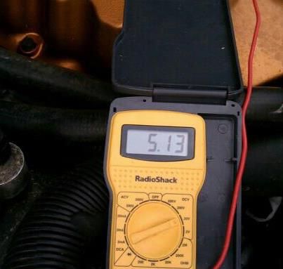

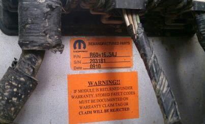

SO i finally had a lightbulg go off in my head and understood the whole map adjuster concept. Heres the problem now. I am reading 5.13 volts off the map supply without any modifications all i did was unplug the map and it is reading with the key in the on position 5.13 volts... Anyone know why this is? My jeep does have a mopar reman PCM in it. ill post pics

Mine does the same thing. Everyone says 5.0v but it really gets 5.13v. I think that is so that if the ecu gets that high volt back the it throws a CEL and a 'bad MAP' sensor. If you turn on the key with the map plugged in, the signal v will be like IIRC 4.67-4.73v depending on your altitude.

CobraMarty wrote:Mine does the same thing. Everyone says 5.0v but it really gets 5.13v. I think that is so that if the ecu gets that high volt back the it throws a CEL and a 'bad MAP' sensor. If you turn on the key with the map plugged in, the signal v will be like IIRC 4.67-4.73v depending on your altitude.

showtime3492 wrote:I am reading 5.13 volts off the map supply without any modifications all i did was unplug the map and it is reading with the key in the on position 5.13 volts... Anyone know why this is?
Probably a normal slight variation so don't sweat it. Even my own stock MAP reference voltage was 5.05v.
