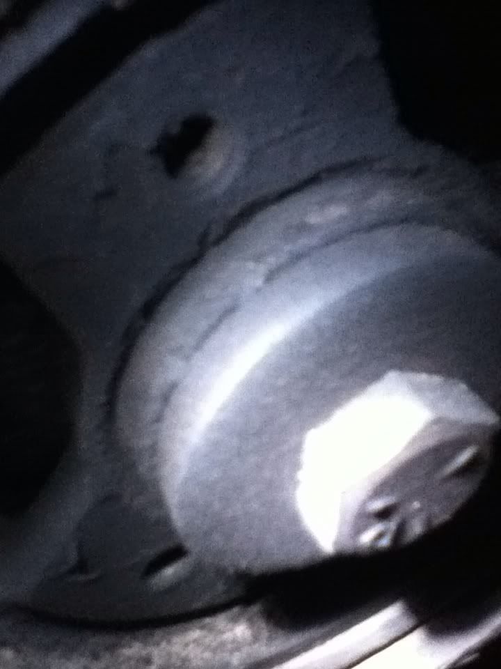

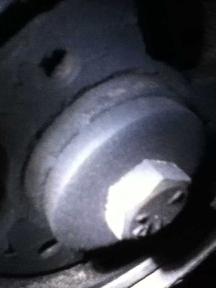

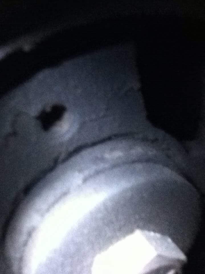

ok guys, here is the harmonic balance bolt and its washers. it is very hard to get a flashlight and an ipod in there to take a clear picture so this is as good as i could get
We broke something, I think it was traction.
Re: how to tell if you have a stroker?
That is a good enough picture, and yes that appears to be the spacer in question.

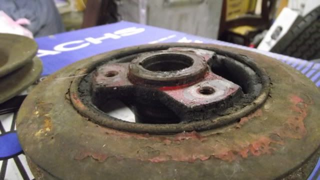

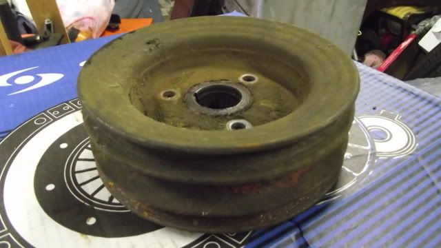

I don't believe the photos superj posted are of the "spacer", they look like a 258 dampener to me, it looks like the pilot on the hub that's for the auxiliary drive pulleys, here's the one off of my 258, the spacer should be about 10mm thick, like the one tequila mike posted.
Is it a "V belt or a serpentine setup?
superj
