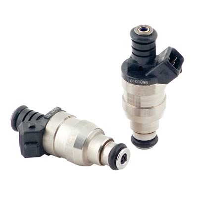

What do those Accel 24lb'ers look like? Is it ACC-150124?
