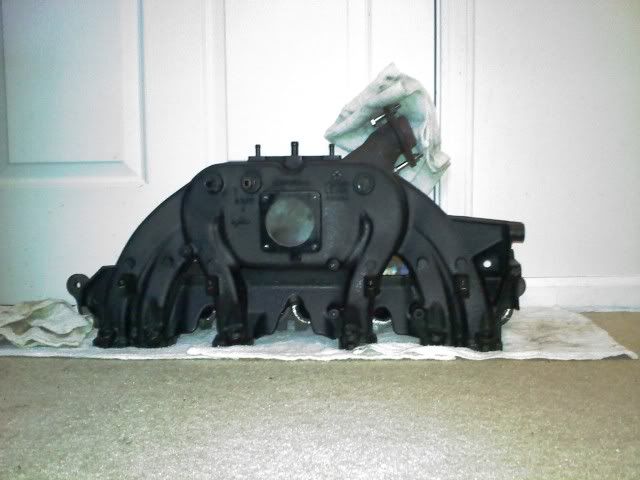

Re: Painting Intake Manifold?
Duplicolor engine enamel, semi-gloss black. I cleaned up the intake runners as well to better match the gasket. Still need to do the throttle body and the header though.

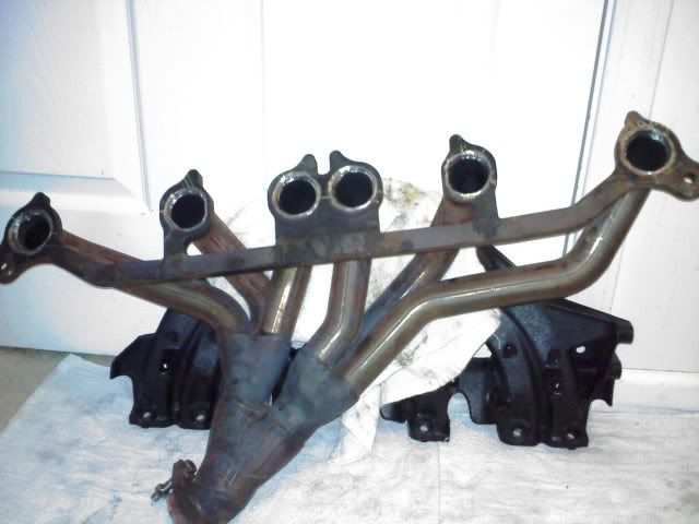

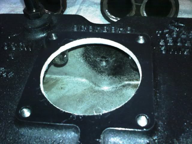

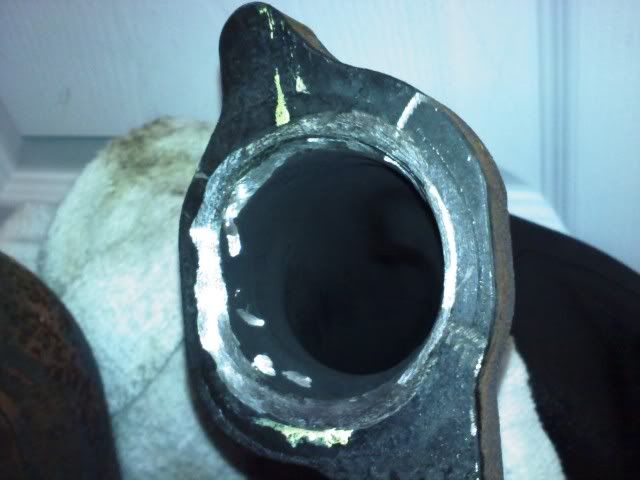

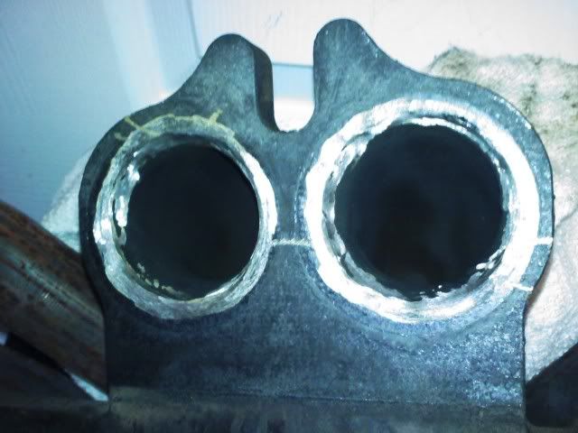

Here's a better picture. I also spent some time grinding down the runners on my Banks header today. Didn't turn out as well as I would've liked but given the limited tools I have available right now I think it will do okay, better than it was anyways.
I hope that header is still able to seal well. From the pics it wools like you took quite a bit out of the gasket surface.
No, I didn't take much at all from the flange. 95+% of the material I took was from the area where the flange meets the runners.....if I get a chance I'll post up some pics of the gasket and the manifold so you can see how the two match up. My main goal was to smooth out the sharp edge where the runners meet the flange.....I think I did a decent job of that. As for where the gasket meets the manifold, they are about equal, I didn't take off material where the gasket was present.SilverXJ wrote:I hope that header is still able to seal well. From the pics it wools like you took quite a bit out of the gasket surface.
I was looking at that again. It's deceiving in the pictures. Some of the spots where it looks like a lot of material is gone there is actually none gone, it just got bumped with the grinding wheel enough to clean it up and make it shine.SilverXJ wrote:I hope that header is still able to seal well. From the pics it wools like you took quite a bit out of the gasket surface.
