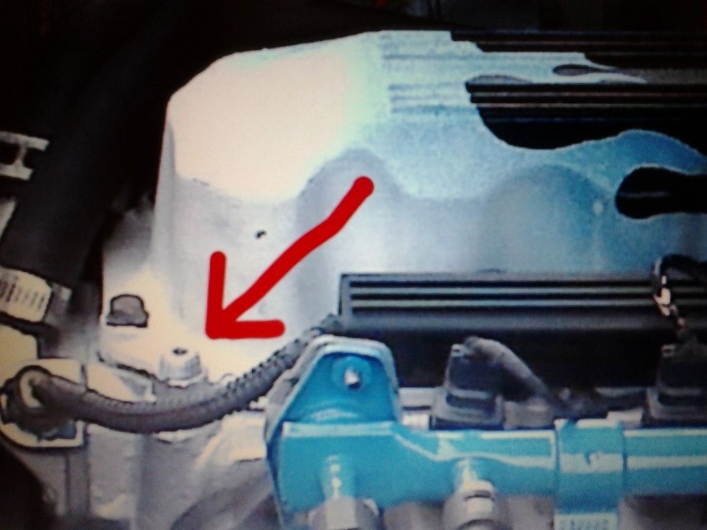

I've been running head studs for years. To pull just the head, once the nuts are off just unscrew the studs. they are installed with allen wrenches.
it's not a great pic, but you can see.
