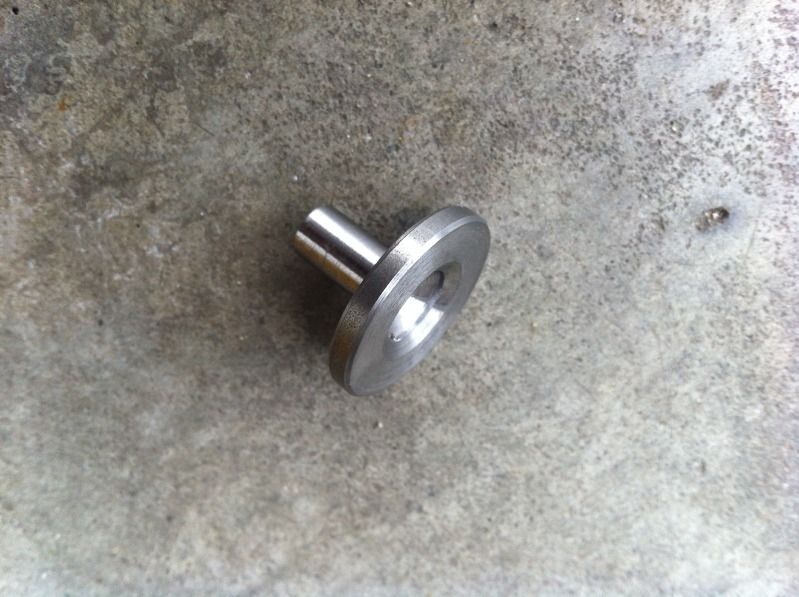

cam wear on the rear frost plug is not normal ... but it sounds like you had some excessive cam movement. whats your cam and head setup ?
i recently just picked up my assembled short block from my machine shop, and with running a mild Comp Cam (201) i opted to have the cam spring/pin setup replaced with a solid pin. my machinist made it and allowed for .005 clearance. much less than what the stock spring/pin would allow for.
here's what it looks like so you can show your machinist or make your own.

Sandrail, that looks pretty slick. What is it made out of?

Silverxj, I think you hit it right on the head. I put things back together and determined the rear plug was keeping the cam forward about 1/10th of an inch. This misalignment of the timing gears caused the chain to wear very hard. It looks to me that after the rebuild the cam may have actually been rubbing on the timing cover before the engine was even started. Eventually it wore a grove into the plug and moved itself back a bit. Ill still probably set endplay manually, so thanks for the idea on the machined part. It sucks to think one expansion plug installed too deep cost me a motor.
lightfoot
