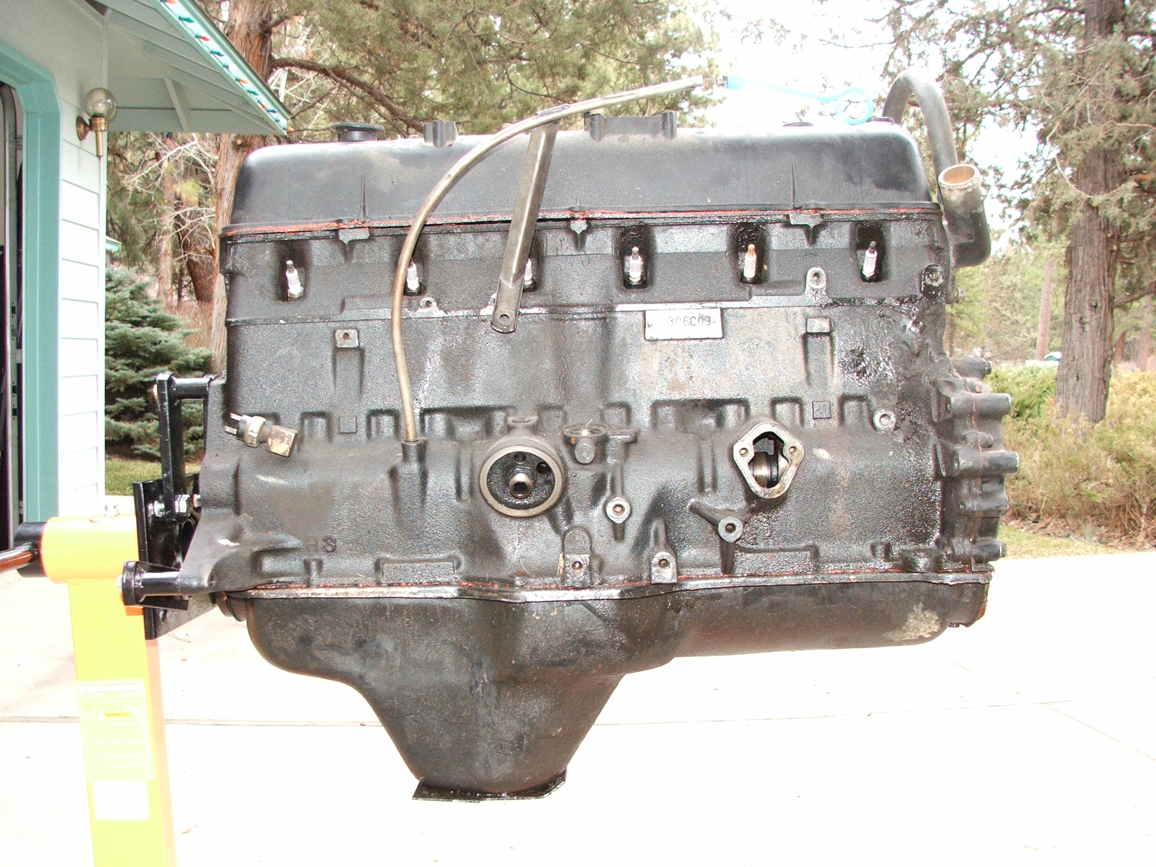

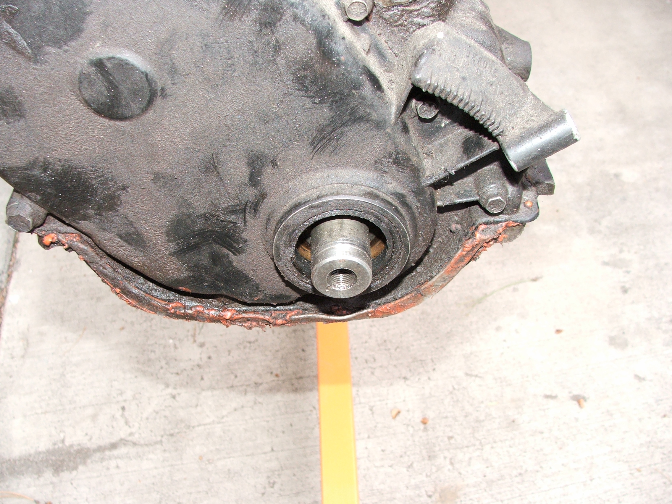

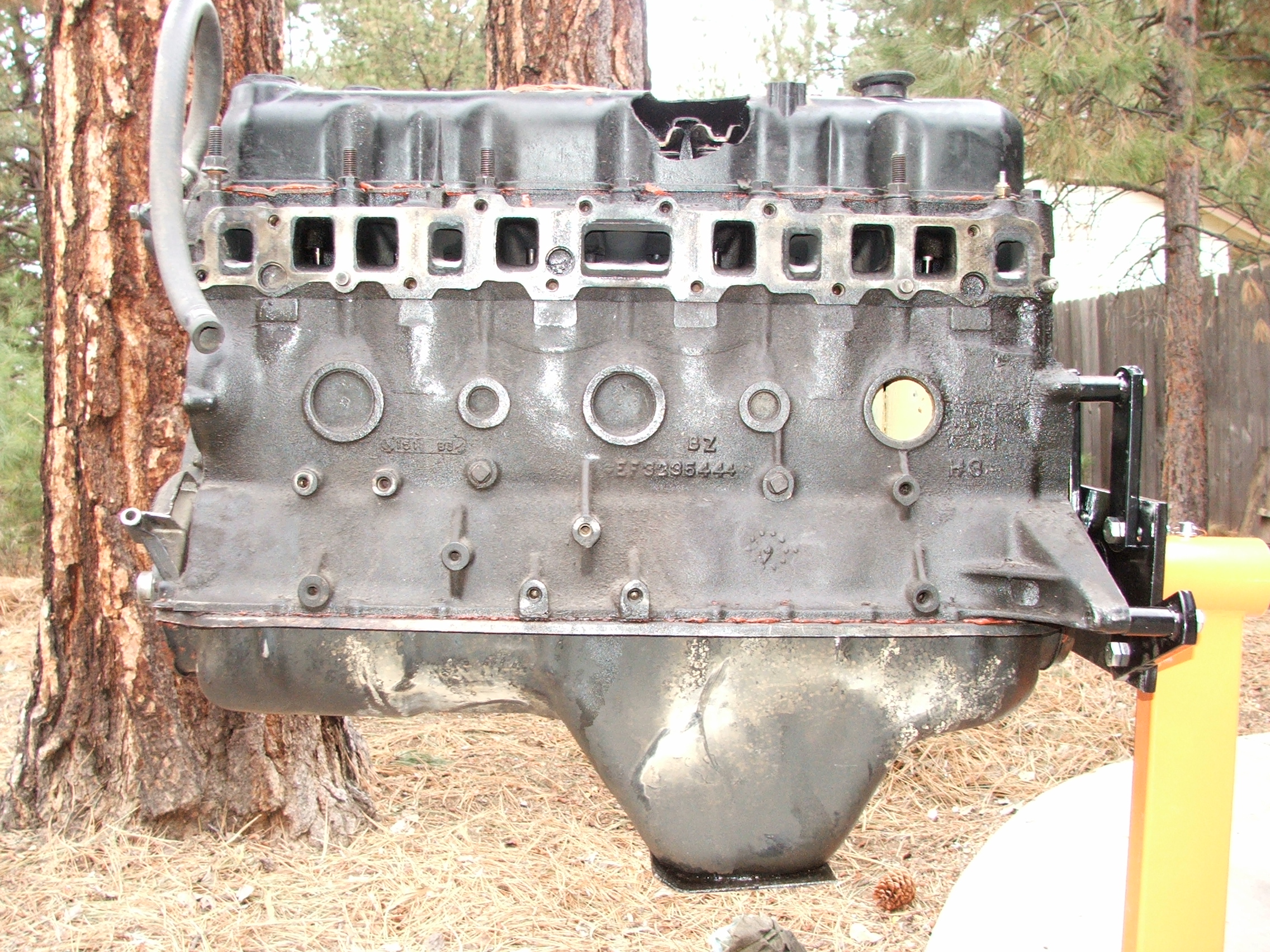

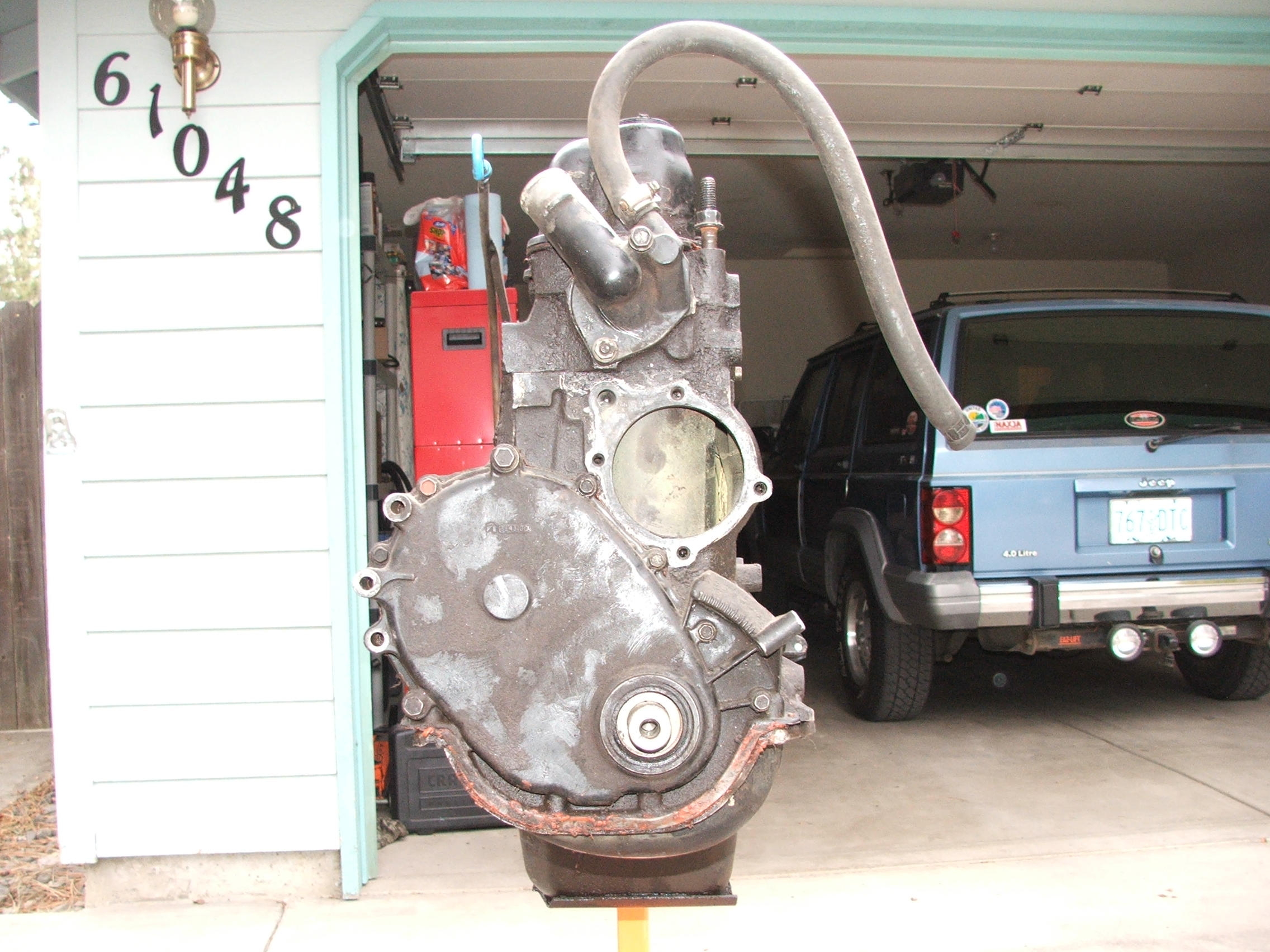

There was a lady on craigslist giving away a 4.2 for free. I called and was the first one :D When i came to look at it, she said sooooo many people called her after me that she should have put it on there for money lol!
Anyway, she said it was from a late 70's early 80's CJ. It was in her possession because her boyfriend was going to use it to replace their current engine, but it turned out that the reason they thought they needed a replacement engine was actually something minor...
I just couldn't pass it up so i took it home. Here are some pics:
Now my questions .. please bare with me. I'm sure there will be many more to come as i have never built an engine before.
BTW the intake and exhaust are there to just not bolted on anymore. Nothing special it seems there though... i think they were all carbureted right?
Now from the information i have given you, and from the pictures is there a way to tell that what i have will work? I'm not sure when i will have a chance to actually tear it apart.. so maybe i could save some work if its obvious it doesn't contain what I'm looking for. (proper crank and rods)

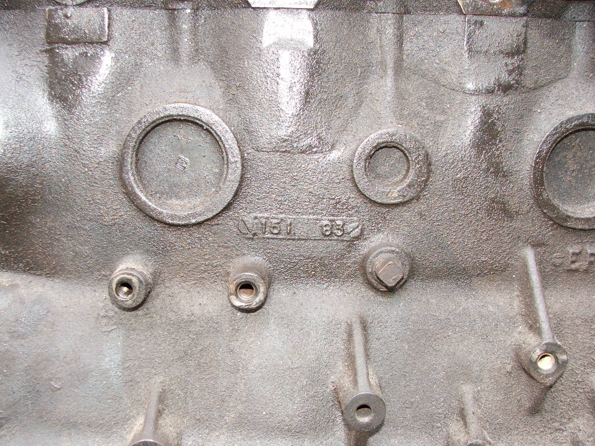

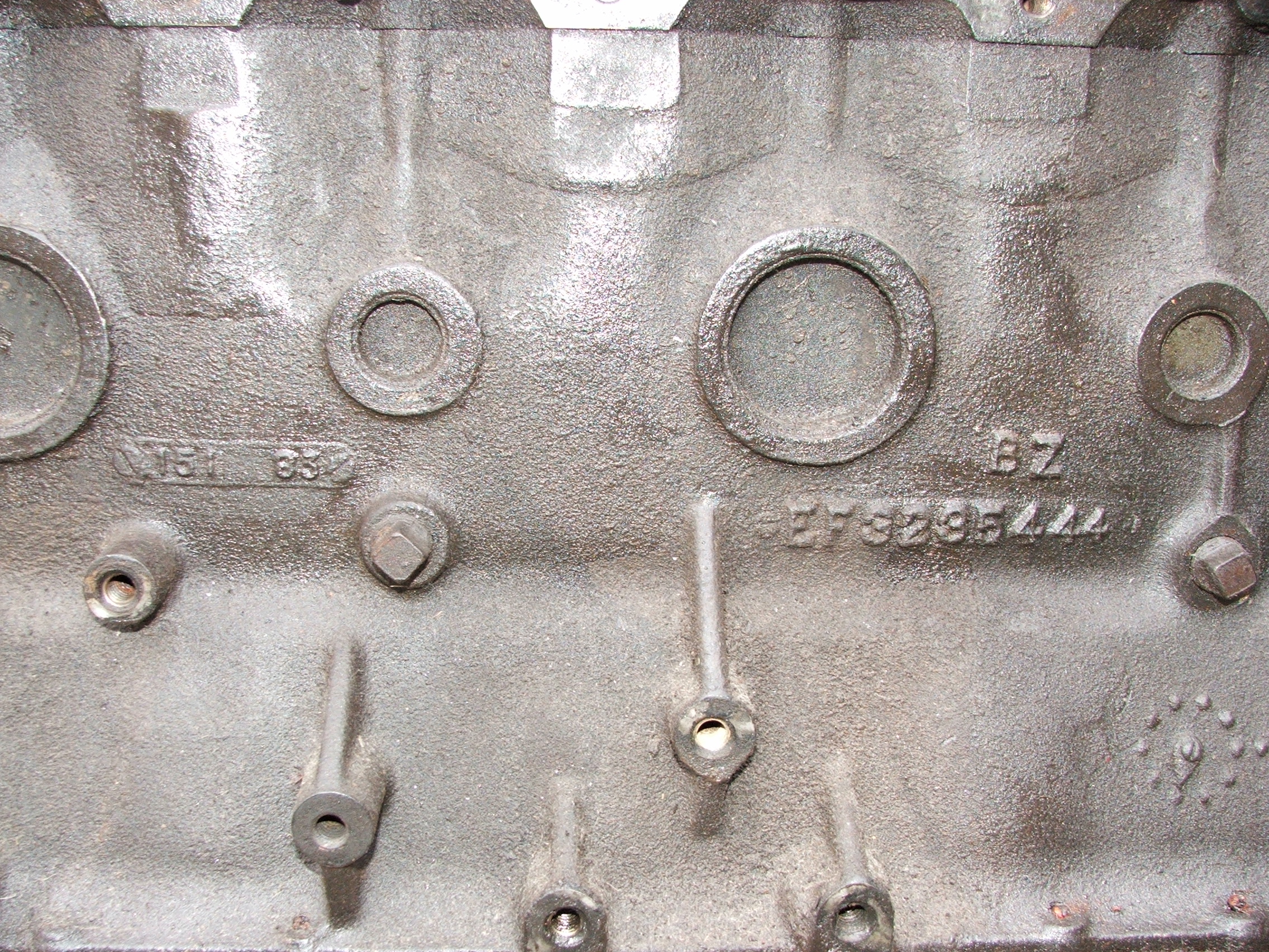

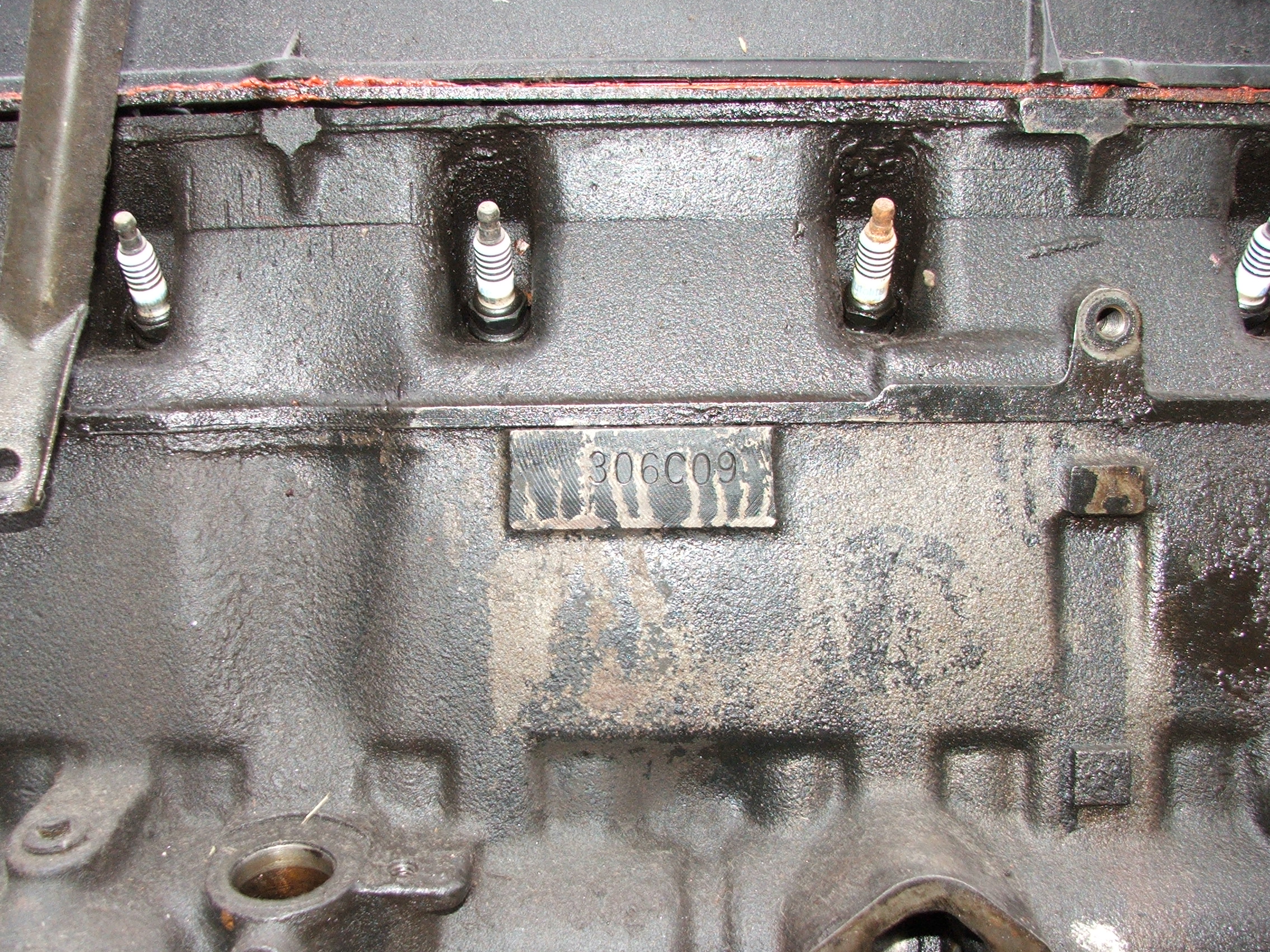

I guess i should have searched the web a little bit ;)
Code: Select all
ENGINE DAY BUILD CODE. This is located on the passenger side of the block just below and between #3 and #2 spark plugs holes. It's a flat plate and has this format:
The Engine Day Build Code consists of six characters:
1. Year built code
2. & 3. Number of the month
4. Engine size/type code
5 & 6. Day built
So in my case:
306C09
Probably 1983 On June 9th.

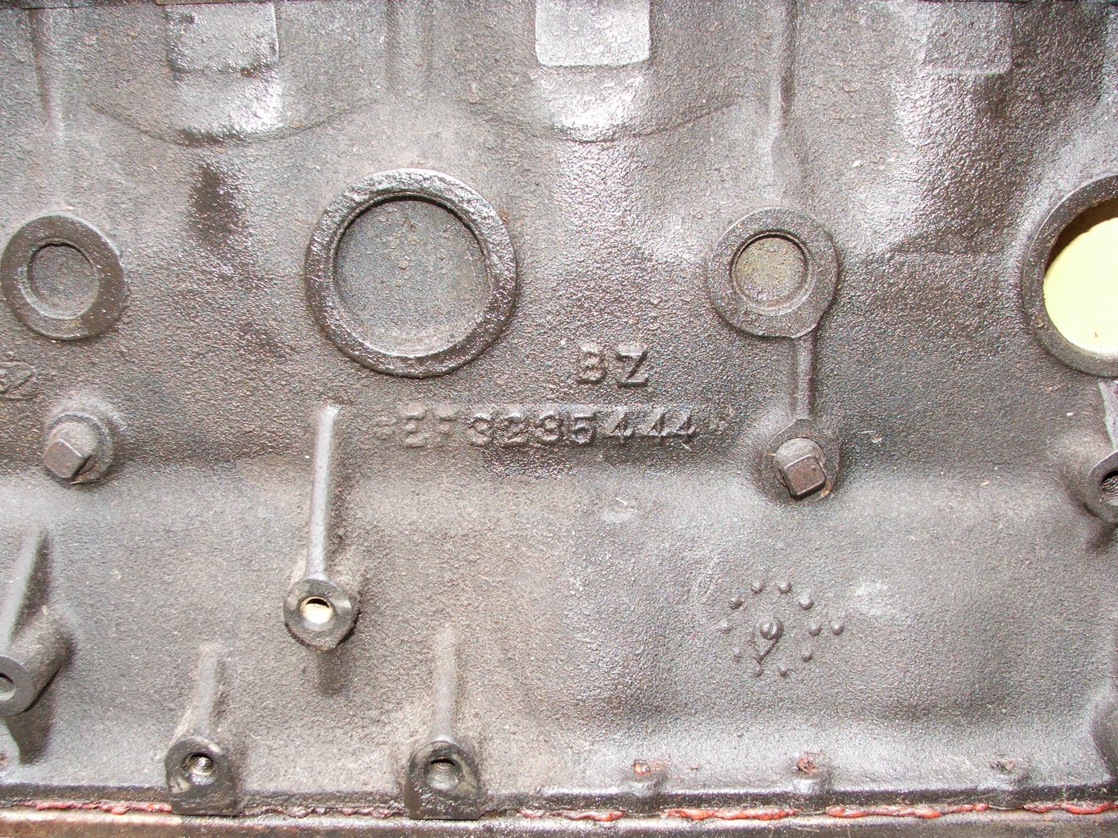

Serial number is the other long number on the block:
In my case:
EF3235444
This site also has good info:
http://www.geocities.com/cantwait_forvi ... ingnumbers
So it appears that i will probably have crank casting #3235477 which is close to exactly what i wanted to have! a 4cw but i will still have to cut the snout or go with a spacer... (im gonna get it cut).
Re: Muad'Dib thinks he found his start to a Stroker Build!
That's about all the more I would have payed for that engine too, that's the price I've had to pay for the last 3 or 4 12cw 258's I've gotten, in fact the last one was loaded on my truck when I wasn't looking!, it should yield an acceptable crank and rods for a stroker.
