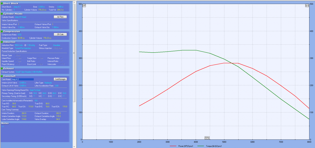

I suddenly have my eye on the 81-90 4.2L cam. Seems like it fits in between the early 4.0l cams well and keeps cylinder pressures within the range of 87 octane.
Thanks to the USAF, my wife and I now live on the east coast at Dover AFB where I've heard the humidity is horrid. Perhaps not Florida horrid, but worse than we're used to. This Jeep may see up to 3500lbs of trailer weight behind it and 90+ degree days of high humidity, so I'm just trying to pick a cam she can drive every day without wondering "if the engine can handle it"...
4.2L '81-'90 cam specs: 262/262, 191/191, .405/.405, 114lsa and 113icl...makes for 9.57:1 compression and a 7.73:1 DCR. I've been under the assumption 7.5-8:1 DCR is best for 87-89 octane, and lower if we're at sea level towing on a hot muggy day.

Re: 4.7L stroker build happening soon, time to pick cam
If anyone wants the full size image...
Those curves don't look right and the reason is that you've entered a seat-to-seat duration of 262 degrees. If you enter a 0.050" opening duration of 191 degrees which would be the correct way to do it, the results will be very different (lower rpm peaks for HP/TQ).
Interesting catch. What do you think about using a 4.2 cam instead of the early 4.0 cam?Cheromaniac wrote:Those curves don't look right and the reason is that you've entered a seat-to-seat duration of 262 degrees. If you enter a 0.050" opening duration of 191 degrees which would be the correct way to do it, the results will be very different (lower rpm peaks for HP/TQ).
I wouldn't bother. The 4.2 cam has too little duration & lift and the performance in a stroker would fall off dramatically above 4000rpm. The early 4.0 cam that I'm using is a much better choice and my dyno numbers speak for themselves.Rinkrat456 wrote:What do you think about using a 4.2 cam instead of the early 4.0 cam?
