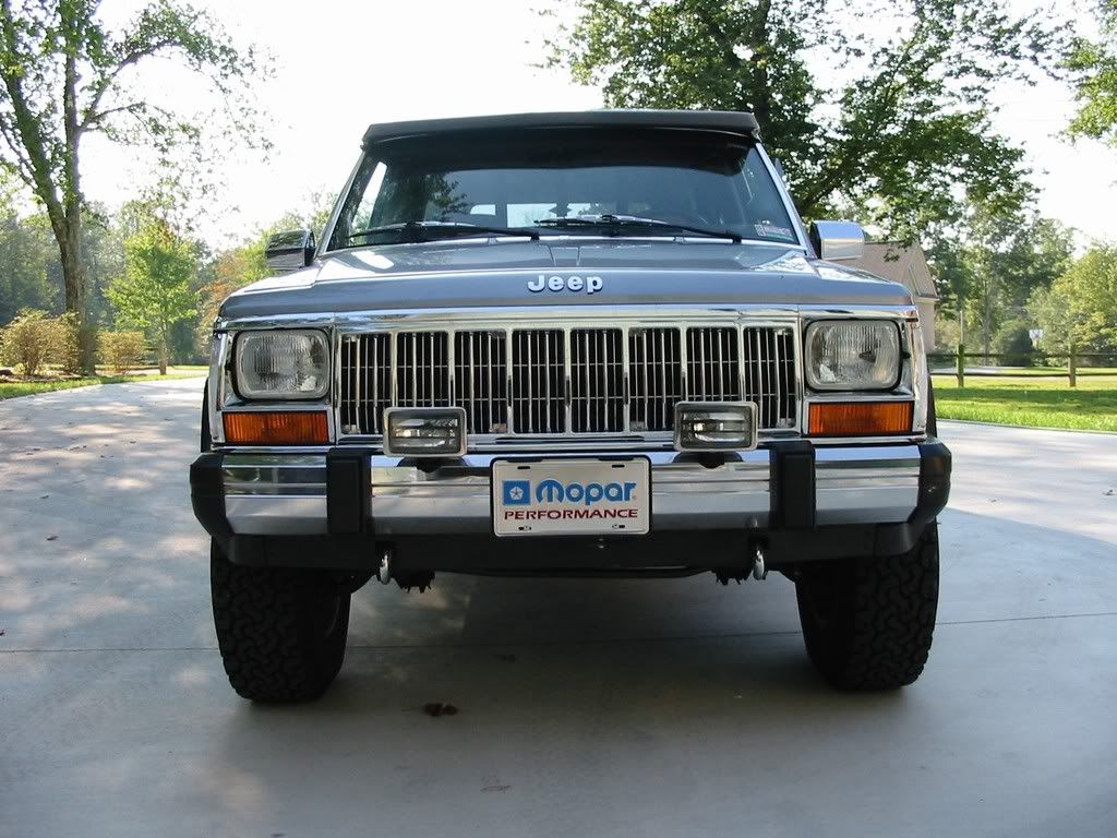

Lol. Starts here:John wrote:What is this chrome thing you list in your signature.![]()
John
Ends here:
91 Comanche LWB, AW4, Hesco 4.6L, D44 Trac-lok, CHROME freak, ROLL TIDE

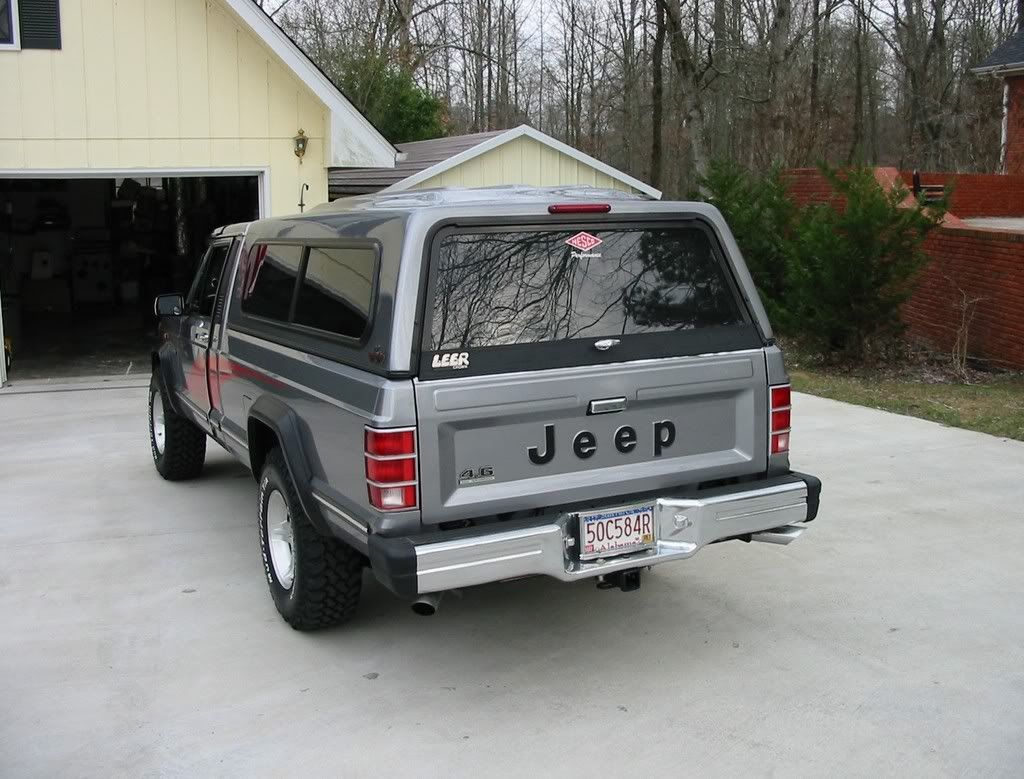

Re: 99+ Intake Manifold & Unichip Mods w. Dyno Results
The motor was listed by Hesco on my receipt as 4.5L, p/n HES4.5, so I ASSuME it's 4.5L. The 4.6 badge on the tailgate is actually from a Mustang 4.6 Hi-Po (closest I could find).gradon wrote:Man your ride is clean. I've been meaning to ask why you have 4.5l listed when you had it bored .030" over. And then you have the 4.6l badge. Do you like to puposefully underrate it? Also I've been effin around with the PSC1 and I dig on being able to control the fuel and do my best to get the trims to 0 and WOT to 12.5:1 AFR, but I must say that in the 2 or so years reading about strokers, you have surprised many with what the Unichip was able to tune out of it. I'm always gonna be curious what a little timing here and there can do for my baby.
