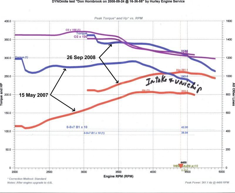

Comanche91 wrote:Got the 2001 WJ intake manifold mounted and the Unichip wired in on my 4.5L Hesco stroker and had the Unichip programmed and was dynoed at Hesco today; amazing results. The dyno peak HP vs. torque BEFORE readings last year were 207.5 HP @ 3950 RPM, torque was 243.0 at this RPM. Peak torque was 280 @ 3600 RPM. The AFTER reading, manifold only, was 219.5 HP @ 3916 RPM, torque at 294.9. The AFTER reading w. manifold and Unichip, was 261.1 HP @ 4400 RPM, with torque at 312.8. Peak torque was 345 @ 3500 RPM. All readings are at the rear rear wheel of course. :D
That's a HP increase of 53.6 (although at a higher RPM, 3950 vs. 4400) and a torque increase of 65 ft. lbs. at about the same 3500 RPM, even w. the 20%-25% power robbing AW-4. Just the updated intake w/o the chip gave impressive gains. Very worthwhile mods.

Cheromaniac wrote:Amazing dyno numbers. Can you post the dyno charts?
Hi Dino. I don't have a scanner, but I'll drop the charts off at a friend's and have them do it, and will post tomorrow. Would like to have you guys comment on them. Don

Here are the dyno charts, with last readings superimposed. One is for the new manifold only, the other is the manifold + Unichip:
